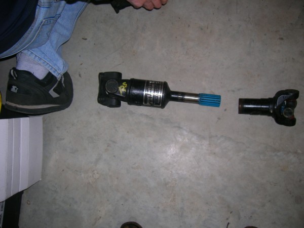

    117
    Name:  slip joint.jpg
    Chevy 3/4 ton truck slip joint
    Robert Boyce found running stock Corvette half shafts with his 680 hp engine didn't work. He converted these truck heavy duty slip joints to take the place of the weak stock half shafts.

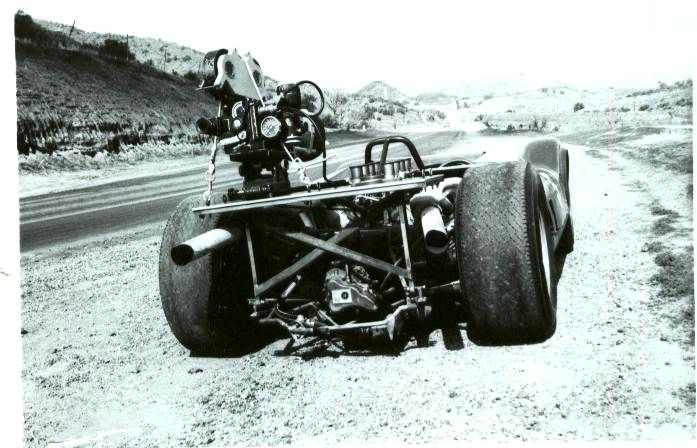

    New rear trailing arm made by Robert Boyce.
    On the Cheetah I had this part failed causing the rear tire to go under the car. Robert has made his new trailing arm assembly out of thicker material and more in the sprint car type of trailing arm than the original Cheetahs had.
    I asked Robert when you first starting driving the Cheetah in 2004, what was wrong with it. His answer was "Everything". Over the 8 years Robert Boyce has run this Cheetah, he has made improvements in nearly every area of the drive train and chassis. Note he has mounted the battery on the side of the frame. Robert also is using 1965 Corvette disk brakes. The cars came with drum type brakes.

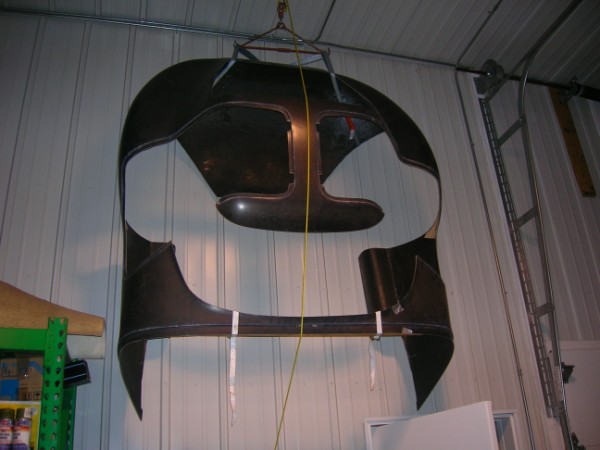

    Carbon fiber Cheetah rear body section
    This is a lightweight body that Robert has for his Cheetah.

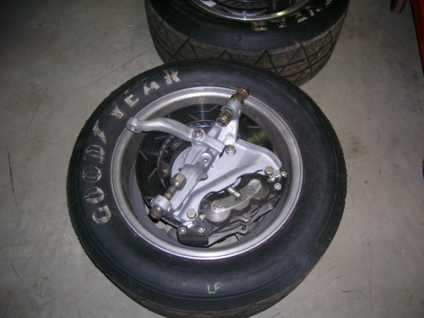

    Front hub assembly
    When Robert Boyce went to the disk brake setup he had to use a 1967 Corvette front spindle. These have larger bearings in them, they are required for the disk brake switch. The steering arm is off a Chevy Impala and not stock Corvette.

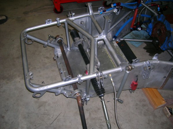

    Steering rack assembly
    Robert didn't feel comfortable with the stock 16x1 steering. He felt it was way to slow. He has a 8x1 rack installed. To achieve proper bump steer the rack was moved several inches from the original mounting place. Robert also didn't like the angle the steering wheel sat at. He has put on a quick release wheel and instead of reaching up for the wheel, he has it angled more straight at the driver.
    Robert also lowered the chassis to sit at 3 1/2 inches above the ground. This required moving suspension pickup points and also lenghtening A arms.

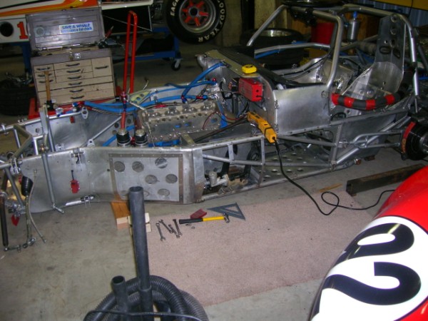

  7. #67
    Jan 2012
    Spring Lake, Michigan
    117
    Name:  side chassis.jpg
    Side view of Cheetah
    Robert Boyce has lowered the engine in the chassis by quite a bit. He has also added disk brakes and quick release steering wheel. He has strengthend the chassis and changed the suspension gemoetry. He has modified the shocks and springs. All this in a effort to make the car easier to handle and safer to run. This is an on going effort of Robert Boyce and his mechanic George Heyder.

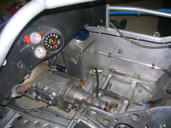

    Name:  motor mount.jpg
    Dry sumped motor lowered in chassis, new mounts made by Robert Boyce
    Wally: Lets put it this way. A Lotus 23 with a legal twin cam 200 hp engine is not going to run with this baby on the straights.

    Cheetah interior, note dry sump tank on passangers side.
    Steve: To say Robert Boyce has interesting cars is an understatement. He has 5 Indy cars all running in like new condition, a Superformance GT 40 a NASCAR ex Michael Waltrip car and Vintage Sprint car and street rods and classic cars. It would be a whole thread on his workshop and collection.
    I will stick to the Cheetah here. I am sure Robert feels the same as you, this is a continuation car and it is legal to take any of the bugs or unsafe features and correct them. This has taken years to accomplish.
