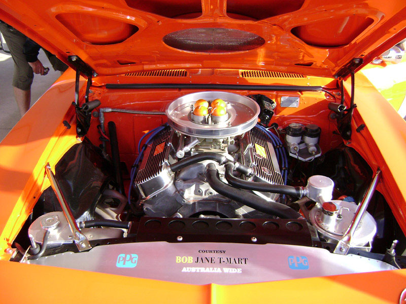

    Here is a photo I took of the engine bay of the Bob Jane Camaro back in about 2007.
    Name:  Misc Pics 045.jpg

    Eric, was your car already fitted with a dry sump system when you bought it? Almost all the cars that race in the Historic Trans-Am group are fitted with wet sump and use very good baffled sumps, as they must be presented as they raced in period. About the only cars that race in Historic Trans-Am with dry sump systems are the 1971 and '72 Javelins. The Rusty Jowett '68 Camaro was fitted with a dry sump when restored on the East Coast of the US. But this car never raced with a dry sump in 1968, and when it was sold to a new owner on the West Coast, where Historic Trans-Am is much stronger, the car was required to revert back to wet sump. There are some very good baffled sumps available if you have to take this route, and lots of good advice for doing this.
    This is not really the solution you want, but at least its good to know you can still make the car reliable. But I will keep looking to see if there are any other Camaros that raced in period with a dry sump.
