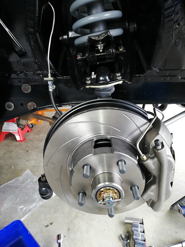

    The rest of my parts arrived yesterday from USA, so I could get on with the front suspension. I fitted the upper and lower control arms, new springs, restored the torsion bar, and fitted the HD spindles.
    The 1964 V8 Falcons had from factory, heavy duty tierod ends, and matching spindles, the drag link and idler arm housing was also HD (you can see it has 3 bolt idler arm housing on the chassis vs Mustang 2 bolt) . When Holman Moody built the 15 cars they replaced the OEM spindle with another heavy duty larger spindle and also used their own HD spring perch as shown.

    I have been fitting the original type Kelsey Hayes 4 pot calipers and rotors, Right side, I needed to rework the rotor back plates to fit the HD spindles. These are the same brakes that were used on the later Mustang GT350s but the Falcon Rallye Sprints also had an in line Hydrovac booster mounted where the battery was.

    Not trying to be a rivet-counter, but are grooved rotors period correct??
  8. #508
    No they are not, but they are only decent rotors found so far, most of the non grooved ones are not produced from very good quality material. Still looking, these will do for the meantime till I find something else.
  9. #509
    Didn't know that. Wow. You don't want second rate materials in the brakes, so I can well and truly understand your decision there!!!
  10. #510
    Rotor warping is a real pain especially under track conditions , bedding them and heat prepping helps a lot but if the metallurgy is not up to scratch it can be more rotor change outs and reskimming etc. Cheers

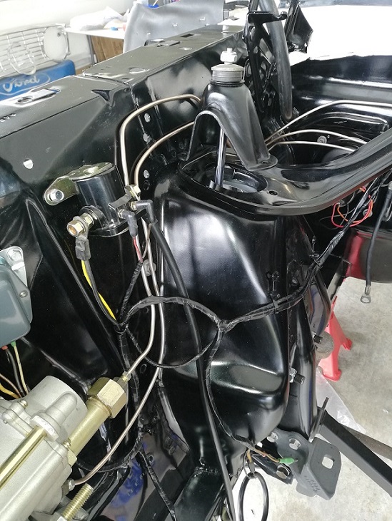

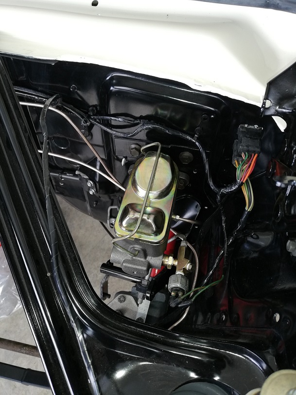

    I made up all of the front brake lines for the master cylinder to booster, booster to junction and to front wheels, then fitted them up. I also finished fitting the brakes and torqued everything down. A lot of brake lines with a remote in line booster but that's how they were made.
    And spaghetti junction,

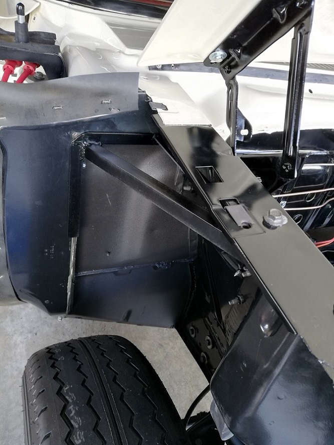

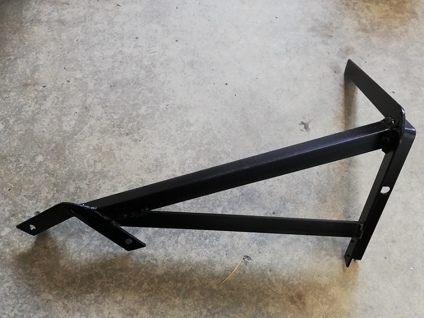

    Fitted the front upper outer shock tower supports I fabricated earlier

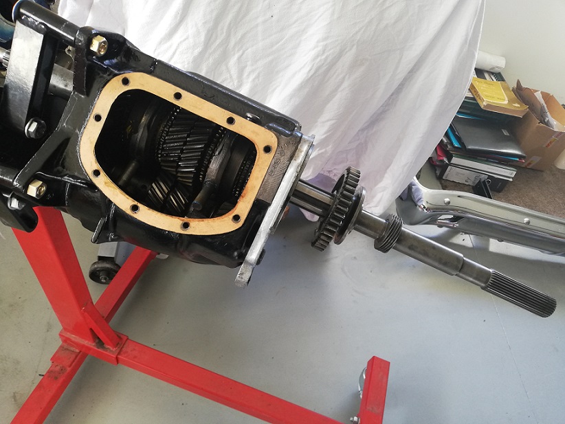

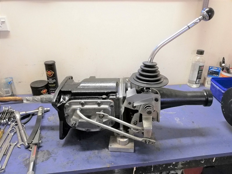

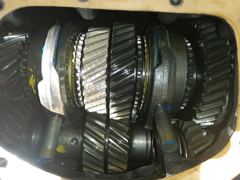

    Also gave the Borg Warner T10 a birthday, this is the first of the Super T10s with 28 spline output.
    It is always interesting seeing the different ways people have reassembled parts over the years in places they should not be.

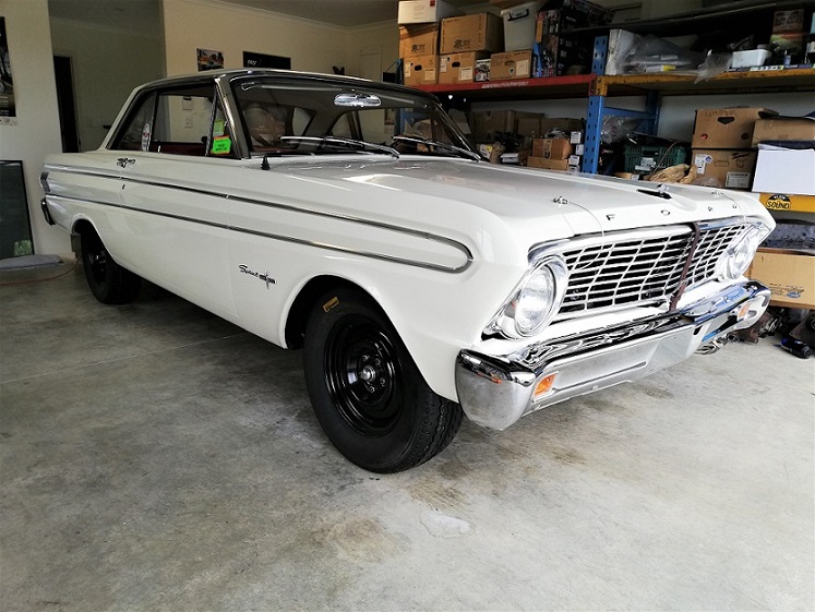

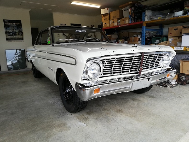

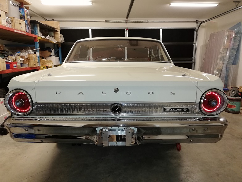

  16. #516

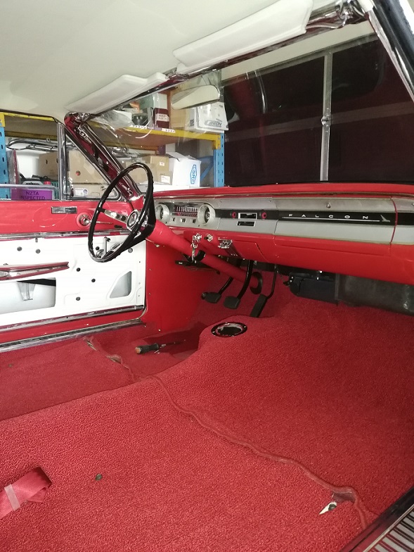

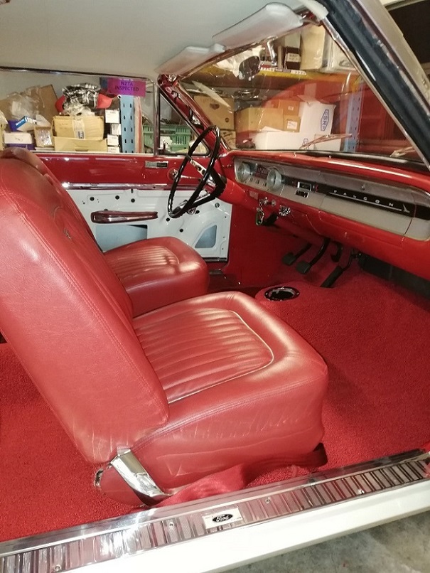

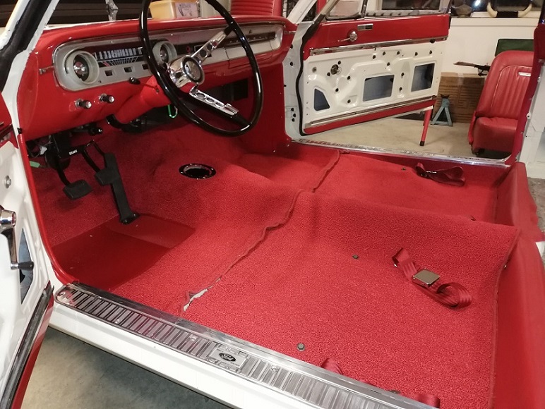

    I have completed the body and trim assembly and the interior also. The wiring is all done and the alternator conversion with diode install is all completed. ready for engine, gearbox and driveline now.
    So this is the road going version to get it road registered and then it will come back for the roll cage etc, it will be running complete interior as the cars did in 1964.
