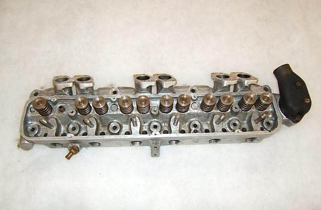

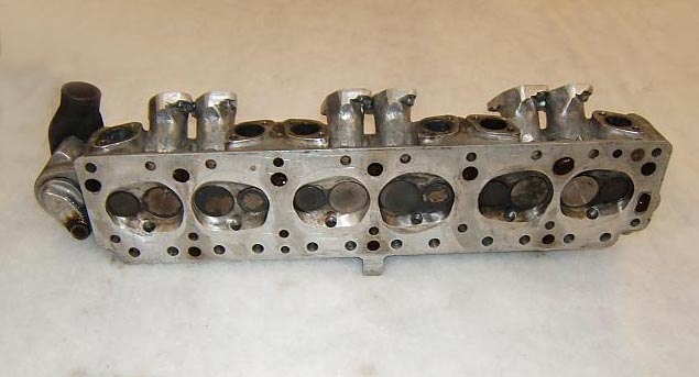

    This example was advertised on TradeMe a few years ago - it sold for very good money I believe.
    Name:  RMZephur head2.jpg
    Name:  RMZephur head3.jpg

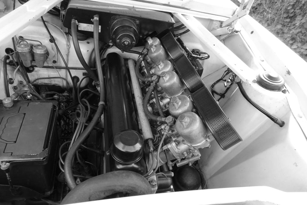

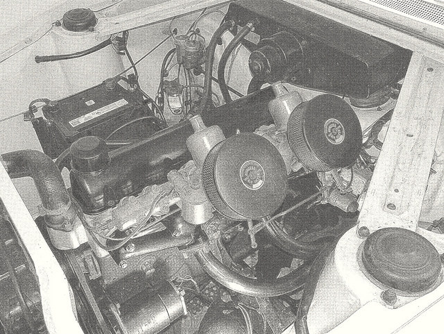

    Cool thread! What are you fitting your reproduction head on?

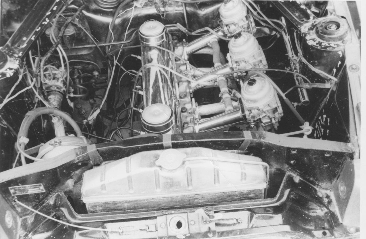

    Thanks Steve. I've had it on the Mk2 wagon for about six months now, initially with two H6 carbs,
    now with lots more
    Looks like it had a well earned life. Those inlet flanges are modified to take something unoriginal, understandable as the stock bolt pattern is virtually impossible to mount anything other than the log type manifold because the bolts are painfully close to the runners. The plug threads aren't quite breaking through into the head face but they are darn close.
    There's a guy out west Auckland who was wanting 20k for one on TM a year or two back. The repro ones are half that even with freight from UK and they have made a number of subtle improvements so they are (seem) very reliable.

    Quote Originally Posted by bce257 View Post
    now with lots more
    Wow thats awesome! Can we see pics of the car?

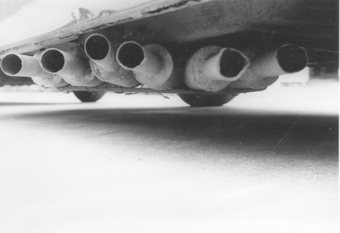

    Rod, that fuel system looks like a fire hazard! SU fuel pump over by the steering column feeding all the way round the firewall to some manifold thing on the other side. Those mufflers are something else altogether. Great pics.
    Ray, the pics didn't come through on my screen.
    Steve, some pics here https://www.flickr.com/gp/57330657@N05/i98RH4
