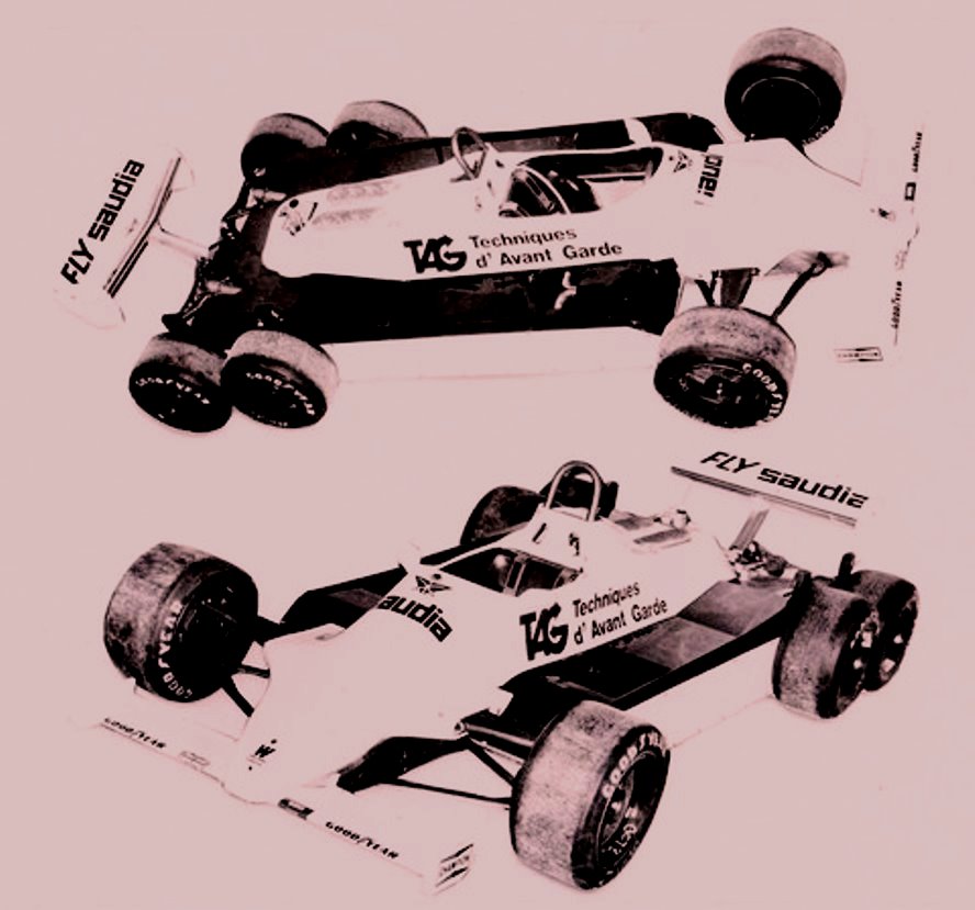

    It reminded me of when Patrick Head sent me a photo of the FW07D 6- wheel project back in 1982.
    As you can see there is more tyre rubber to the ground on the front compared to the rear 4 tyres which is one of the many areas they were experimenting with. This is a brief description of that concept.;
    "This six-wheel set-up would again be four smaller wheels at the back, in a direct effort to improve straightline speed and traction out of corners due to the increased rubber contact, but also to allow the free flow of air along the sidepods all the way to the rear axle of the car. As ground effects were permitted within the wheelbase of the car, Head cunningly interpreted this rule as being from front axle to, well, the most rearward axle! In Head's mind, these would be ground effects almost to perfection. The leading rear axle was placed four inches ahead of its original place, with the driveshafts angled to cope.
    Basically, to get more ground effects within the wheelbase, Head stuck an extra axle on the back to get more room!"
    Name:  1982 Williams 6 wheeler.jpg

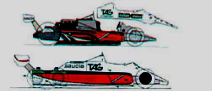

    This is a rough sketch of Patrick's interpretation of the rules that shows in Orange the increased ground effects area gained by using the area from the rear most axle to the front axle.
    As they say Patrick was a "cleva fella"

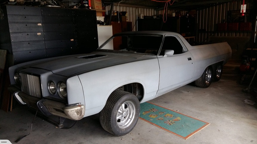

    Here you go Ken,
    You could have a go at finishing this, its got 6 wheels, but a long way to go for F1.
    Currently for sale on Trademe
    Hey Paul,
    I will contact Sir Patrick Head and send him this as a project in his retirement years.
    That might add some value to this vehicle !
    Cheers,
    Ken
