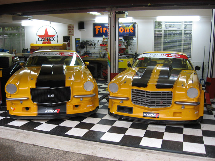

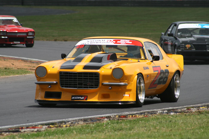

Kiwi racer Murray Brown had this 1970 Camaro built into a race car in 2000. At the time it was built, there weren’t a lot of places to race it, but several muscle cars were competing in a New Zealand class called Super GT, which was a sort of anything goes style category that allowed for plenty of creative thinking without the hindrance of too many rules. Murrays Camaro was built with a 383ci small block, the body was acid-dipped, and full rollcage was fabricated from mild steel tubing. The trunk lid, hood, front clip, front spoiler, front guards, and doors were all made from fiberglass, from a set of molds created for a similar car built up for Wayne Anderson a few years earlier. A large rear spoiler was fitted, along with Perspex side windows, and 17” x 11” Simmons wheels, and slick tyres. The standard Camaro rear end with leaf springs was removed, and replaced by a 9” with coil-overs and Watts-linkage, although all the original mounting points were retained. 6-pot Willwood brakes with 330mm rotors and 4-pot with 305mm rotors did the stopping.
The Camaro was finished in custom a yellow-mustard colour black stripes over the hood and trunk lid. As you’d expect, it was a bit of a tarmac shredder. Murray raced the car in Super GT for a few seasons, then when a new muscle car class called Central Muscle Cars was formed in 2004, Murray began racing the Camaro there. CMC was a competitive series, but Murray was never too interested in chasing points, he just picked the events he wanted to compete at; sometimes 2 or 3 races a season, sometimes none.
