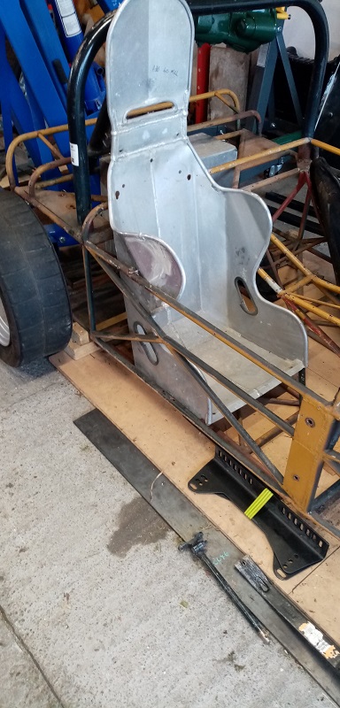

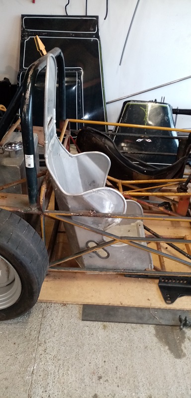

    The thin fiberglass seat that was fitted to the car was mounted in with a self taping screw so something more substantial is called for from a safety point of view, a used alloy seat from a speedway car will fit the bill with a few modifications and will be able to be mounted mounted to the floor/frame with some race car mounting brackets. the wings at chest height will need to be trimmed back a bit and the headrest will need to be lowered and the padded cover is a little tatty so it will need a tidy up and some more padding but it fits in the rather narrow cockpit [42CM] and my butt just fits into the seat with my race suit on.

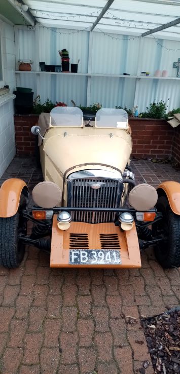

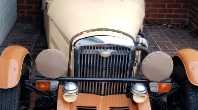

    Hi Roger yes an interesting little car I have been working on it in my driveway on sunny days and have had guys stopping going past to ask what it is. everyone loves it and would like to take it home. I have been calling it a kit car but it is more a one off special and it handles like a proper sports car. it was cheap to buy and I have spent about the same amount on parts to bring it up to a usable standard so the girls can have some fun.

    The Wolseley Special is done got a Rego and WOF today so just some fine tuning as things pop up. its been a fun project and it go's pretty well for 1147cc and it handles like a sports car due to it being so light I guess . I will have it out of the shed here in Waimate by xmas and up to my Chch place for the missus to use so I can get back onto the race car. its been a while since I could work on it so I will not have it ready to race this summer but next summer will be my aim now. but happy wife happy life.

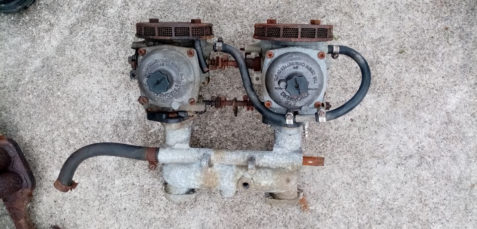

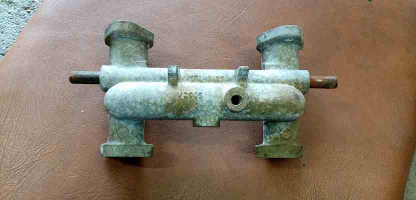

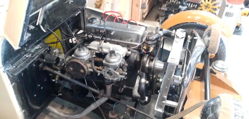

    Still not working on the race car had a few issues with the wee car the carb was flooding and I put this down to the electric fuel pump so changed it out for a new stock crank driven pump still the same issue and while waiting for a needle and seat for the single Solex carb I swapped what was left of my Herald $50 parts car for a set of twin Stromberg carbs and manifolds for the 1150cc engine so after a rebuild on the carbs I fitted them and due to the larger size the bonnet would not close without fouling on them, So I needed a few mods the intake was shortened by removing 30mm from the runners this got the carbs closer to the engine and only a small mod was needed to the bonnet to fit. just a few more small jobs and the car will be ready to hand over to the missus and I can resume work on the race car. No rest for the wicked.Name:  IMG_20230117_131530.jpg

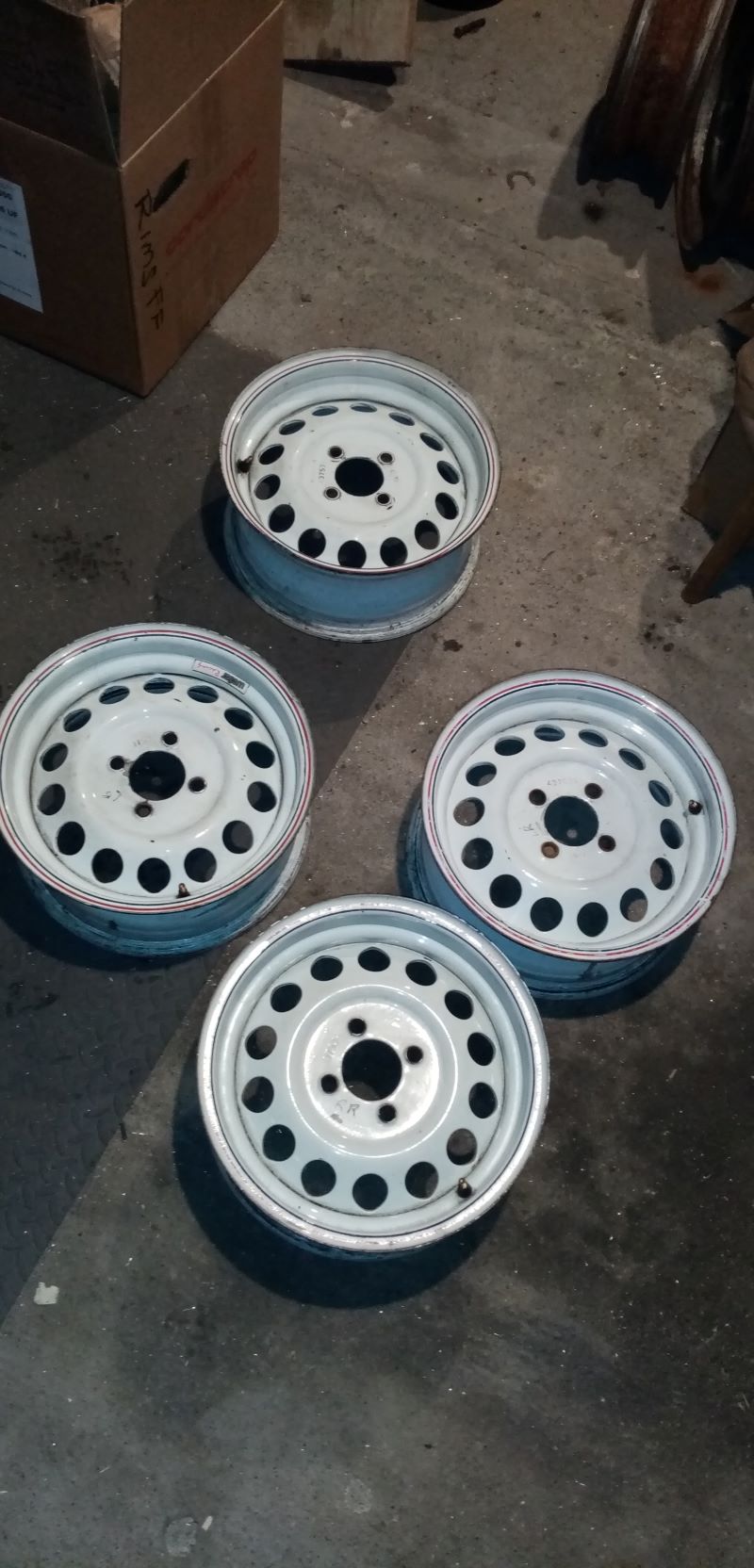

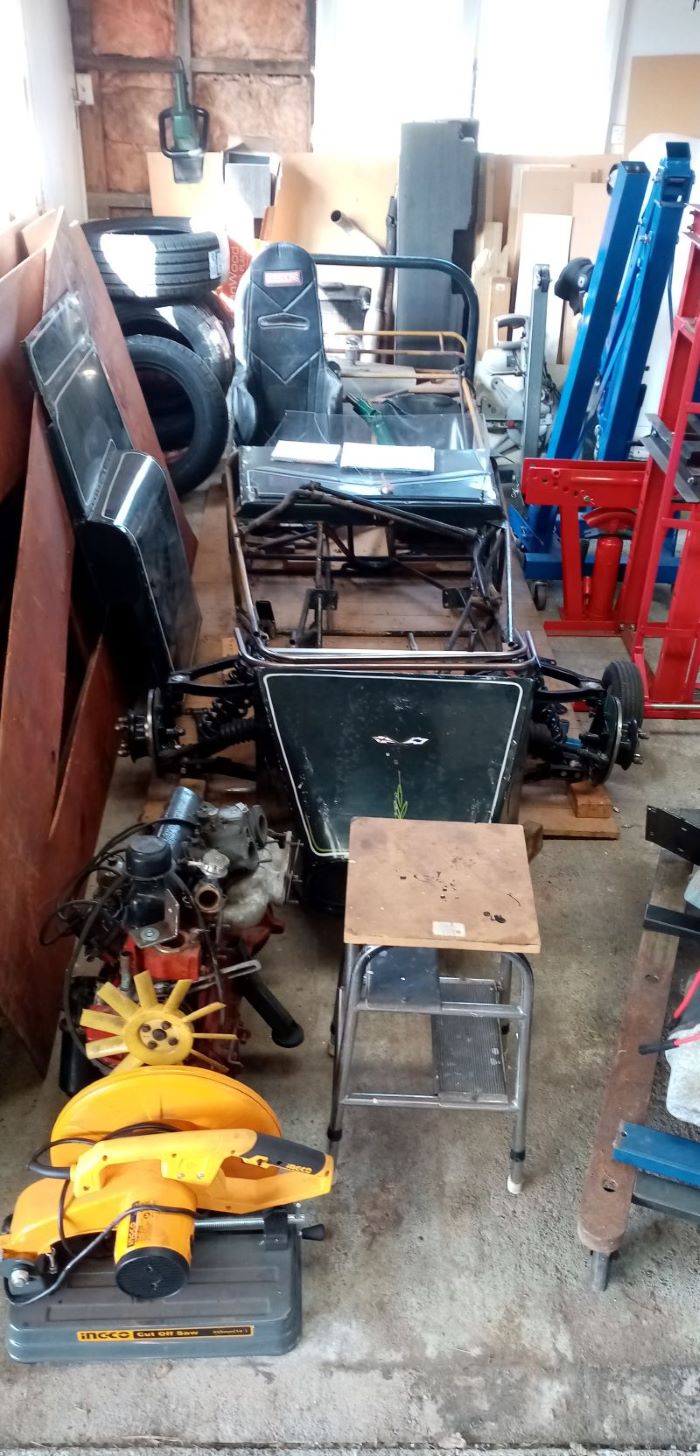

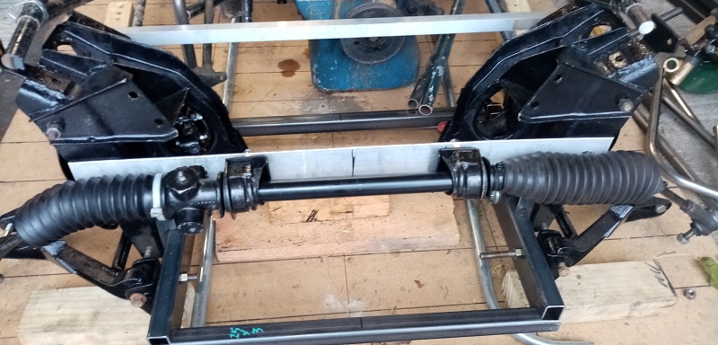

    I have done very little to the race car lately due to work and family commitments and the fact that I have run out of room in my shed but I have managed to get most of the parts that I need for the rebuild and a set of used Weller Formula Ford wheel rims to replace the widened triumph rims that where fitted to the car these had been widened by using steel bands like they did back in the day they are in good condition but I would not trust them at speed. Name:  IMG_20230402_184240.jpg
Size:  162.8 KBName:  IMG_20230417_132237.jpg
