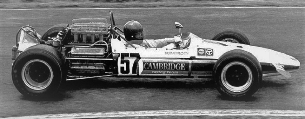

    (T Marshall photo ) Bryan Faloon in action at Pukekohe 1971
    Mr Primotipo himself came up with this Bill Mason photo...
    ...and, like me, still can't fathom how the engine bay was triangulated vertically.
    Perhaps they had bought into using the engine as a stressed member? Fairly substantial structure on the rollbar, for the time!
    The roll bar structure is all about getting the top of the engine bay triangulated...
    There's a triangulated rectangle of tube runs from that across the top of the engine which somehow feeds into the gearbox bulkhead, which can be seen fairly clearly in the top picture.

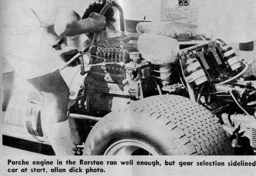

    There is this shot
    Thanks, Milan, again that's very helpful...
    It's not a pretty sight, really, as a racing engine. It has to mount fairly high and all that fuel injection stuff up the top looks heavy too.
    Does that look like a brace from the chassis to the bellhousing in behind/below the link to the frame coming down from above the engine?
    There looks to be a brace going down between the trumpets.
