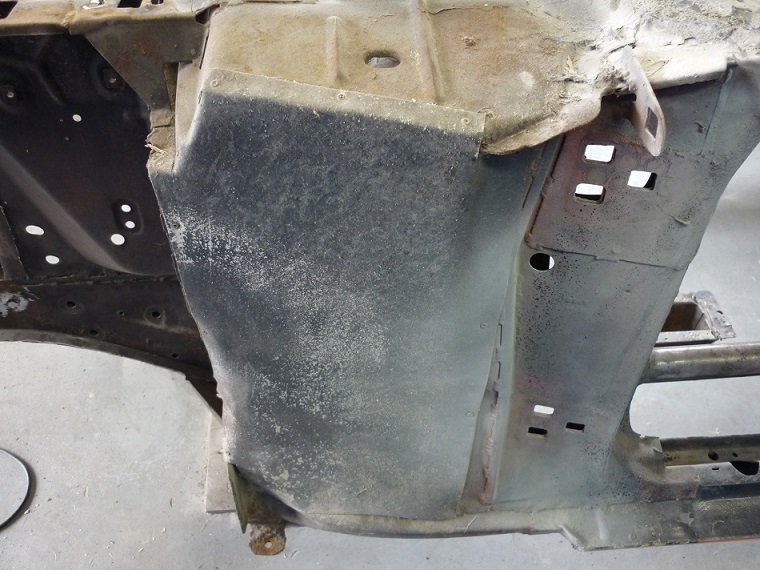

    It sure shows how the mice got into it and chewed holes everywhere, even the rear surrounds.

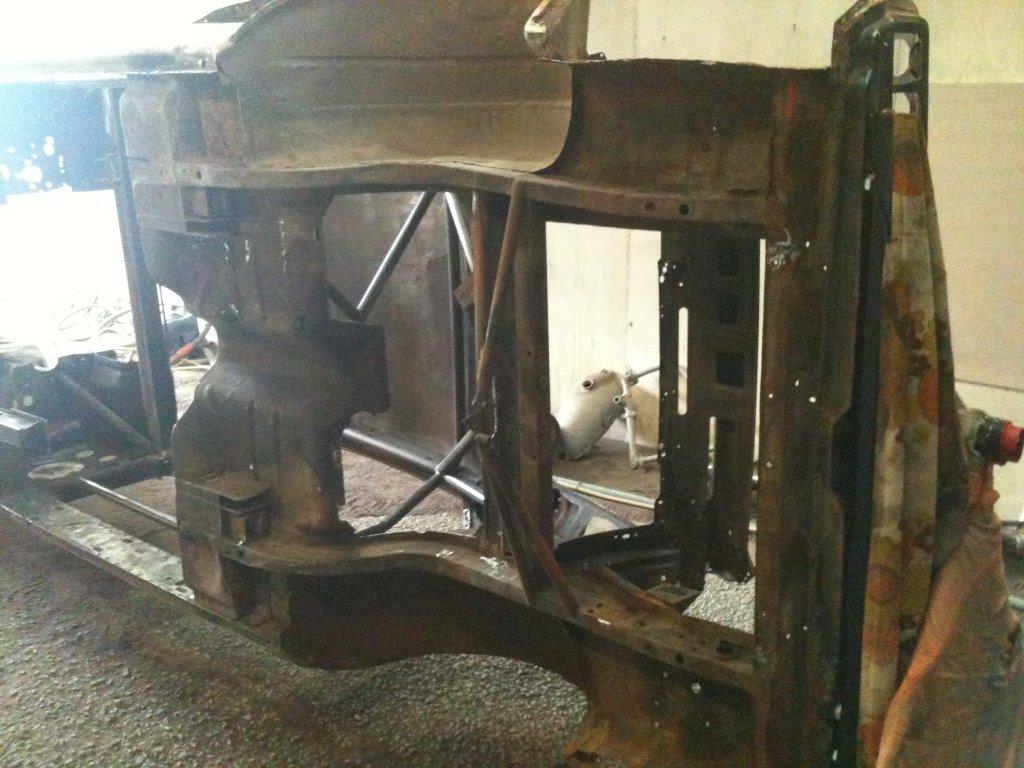

    So here at the front of the car now you can see I removed the front inner RH apron (and the LH one) ready to install the new one and the left and right custom bulkheads needed to be removed so the blaster could get in behind and also because I wanted to replace them with proper ribbed panel steel

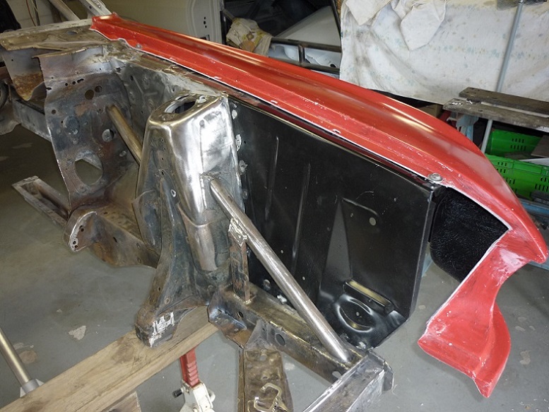

    In the first shot you can see how the RHF Fender and flare have been reworked to the original shape from photos I have of the car when it was rebuilt with the cologne type flares. All 4 flares were a different shape to each other, the LHF being the closest to the original.
    In these next shots you can see the guards have been primed and then sanded with 1200 paper then 3 coats of separating wax and a final of pva that gives a thin glad wrap type coat to help prevent sticking of the mold. The next step was to brush on the resin and apply the resin soaked fiberglass matting to make the mold. I wasn't quite sure why I didn't have photos of this and then remembered my wife would have been real pleased if I had have coated her camera with some nice sticky resin!! The bloody stuff gets everywhere!

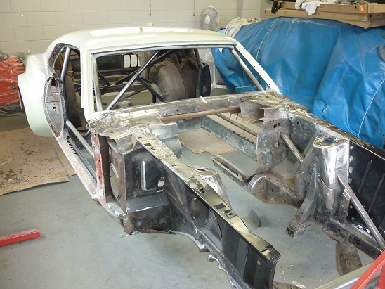

    Here are the 2 L & R front inner aprons after they were installed

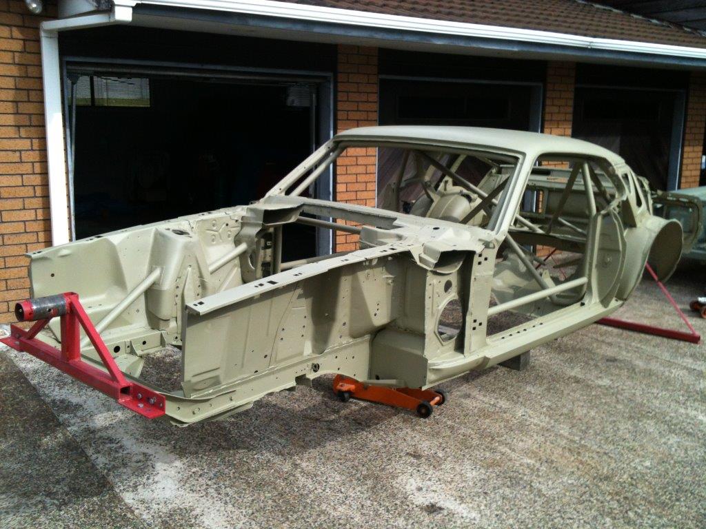

    So then it was time to take it to the sand blasters

    from the sand blasters to Crystal panelbeaters to be epoxy primed in the booth
